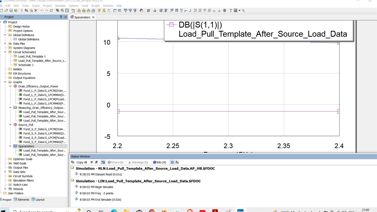

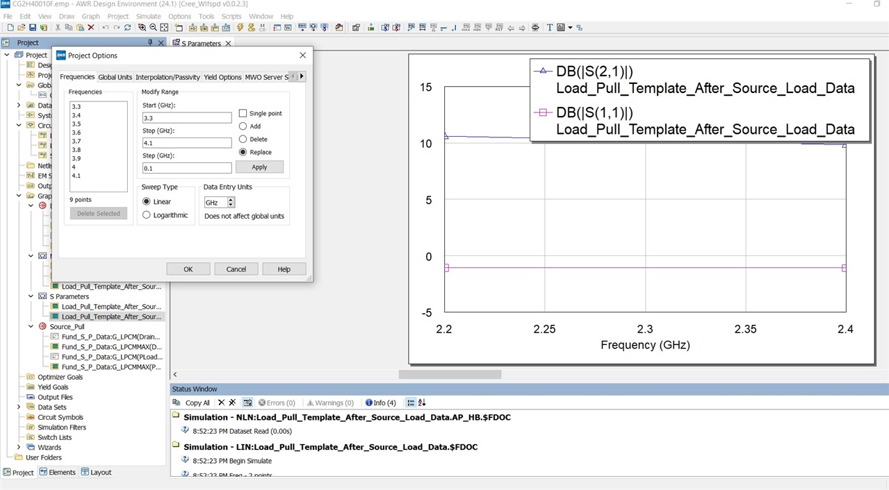

       I have set  frequency fsweep rom 3.3 to 4.1 GHz  using Project Option frequency. When I simulated I am getting different frequency sweep  from 2.2 to 2.4 GHz. I have tried many time, but I couldn't get frequency from 3.3 to 4.1 GHz. Please someone can hep me how to get frequency from 3.3 to 4.1 GHz Sweep while simulating.

    May be Circuit Schematic not set "Use project defaults".

    Change .txt file to.emp. Then you can open file using AWR MWO and look into problem of SParameter graph. Though I have global frequency option into 3.3 to 4.1 GHz. When I opened Graph S- Parameters and it starts plotting 2.2 to 2.4 GHz.CG2H40010F_Modi.txt

    OscPn over 2 years ago in reply to BM202407317753
    You need to select the "Use Project Defaults" for the "Load_Pull_Template_After_Source_Load_Data" schematic
