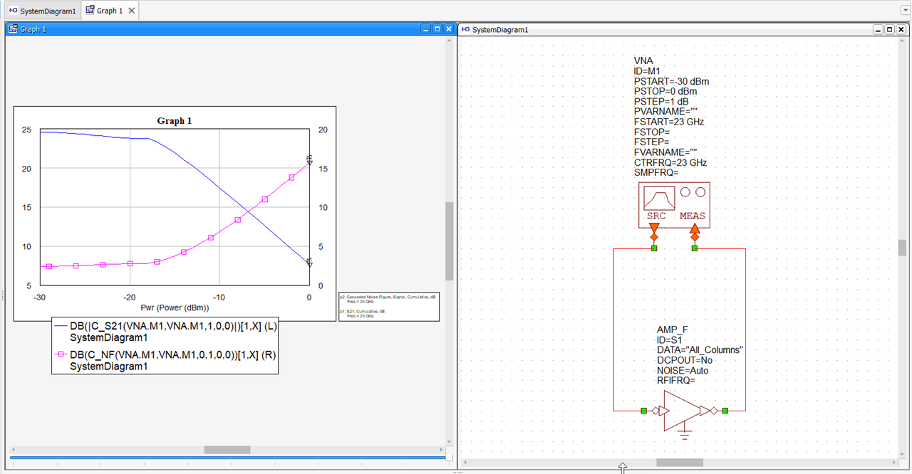

Hello, I was trying to get some measurements like OIP3, OP1dB and such as on VSS. I was using a ADL8142 and connected a VNA to it. I also specified the FSTART and FSTOP as 23/31 GHz and I have added the netlist to my AMP_F. But there is a problem.
1- When all the columns and values from the netlist are available (Freq(,MHz) Gain(,dB) NF(,dB) OP1dB(,dBm) OPSAT(,dBm) RISO(,dB) OIP3(,dBm) S11(mag,dB) S11(phs,deg) S22(mag,dB) S22(phs,deg) OIP2(,dBm)), the measurements for Gain, NF and etc. are wrong compared to the datasheet. Also, the netlist data are directly from their website so it shouldn't be a problem.
2- When I delete all the columns except Gain and NF (Freq(,MHz) Gain(,dB) NF(,dB)) and measure again, they become right.
3- When I add a single column of OP1dB (Freq(,MHz) Gain(,dB) NF(,dB) OP1dB(,dBm)), they become wrong again.
Is there an explanation for this which I am missing? I am new to AWR and especially VSS and it is important for my project. Thanks!

    Can you check the power level on your VNA vis-a-vis the expected saturation on that device?
    I saw something similar to what you describe as the device started to really saturate (started accelerating when the power level of that VNA went more than about -17 dBm or so).  But below that, the data agreed pretty well.
    See screenshot below:

    I tried with the -30 dBm you mentioned in the screenshot and as you said, data agreed well compared todatasheet. In the datasheet around pages 10, we can see P_sat in dBm and most of them start from 8 dBm and go until 15-16 dBm. I think they are consistent and the reason behind my wrong results. I normally used a 0 dBm output power for the VNA. I think that was the answer for my question why it was acting off the datasheet.
