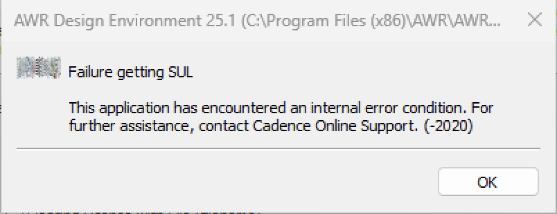

Why I can´t use AWR in my windows 11 virtualizated in my Mac with M4 pro
JA202510023326
JA202510023326 over 1 year ago
Always when I put my username and my password this appears on my screen.

    Hello JA202510023326, I believe you are using SUL. The SUL system does not support desktop virtual machines. I recommend that you file a case on the Cadence ASK portal to verify this, and also share the licensing logs on the case page. To obtain the log file, please refer to the following link:
    Article (20509894) Title: How to set the CDS_LIC_QA_TesT variable and generate qalog file for SUL enabled application (Video)
    URL: support.cadence.com/.../ArticleAttachmentPortal

    SUL is supported only on native Windows (not virtualized)
