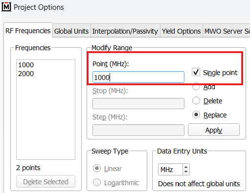

How would I go about adding a singular point at a specific coordinate in a graph?
I want to add a dot to a graph to show the P1dB. My thought was that I can just create a variable in output equations as P1dB=(x,y) and then add that as a measurement in my plot. However, it seems I can't define points in this way, or I am might not know the correct syntax. If I define it as P1dB=y then it automatically shows up at x=1 in the graph. I can't figure out how to set the x value.

    OscPn 8 months ago in reply to DT202506236230 +1 verified
    Try Single Point option

    Thank you for the reply. In my particular case I am unsure of if this is what I am looking for. I have a Pout vs Pin plot with three different frequencies and an interpolated line corresponding to each frequency. At the P1dB of each I would like to place a point to highlight the 1dB compression. Using output equations is there a way to create a point at a certain location?
  • OscPn
    +1 OscPn 8 months ago in reply to DT202506236230
