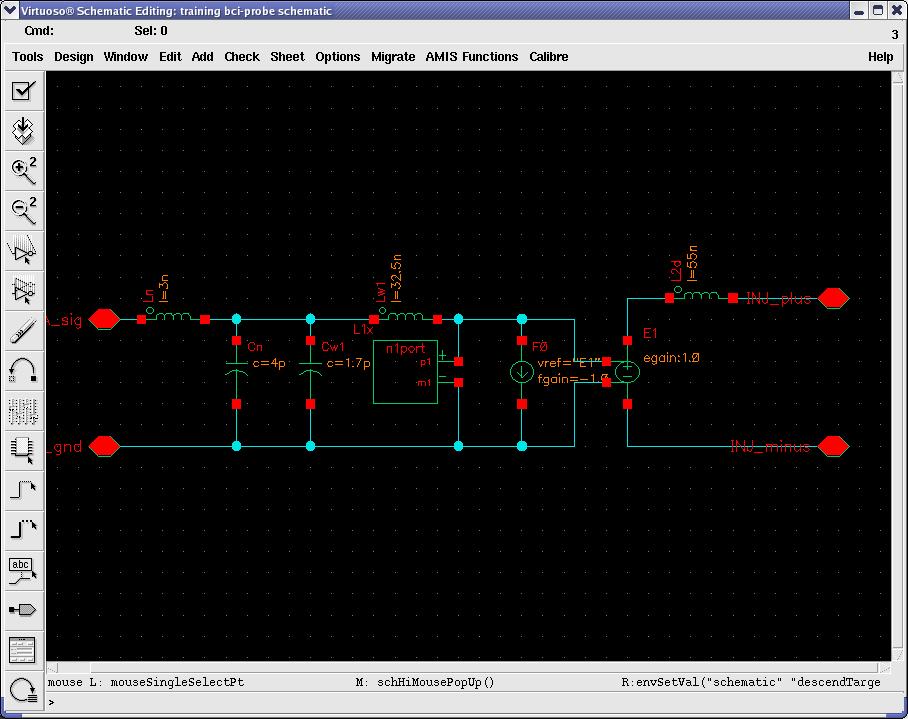

I am currently developping symbols for use in EMC simulations. For example models of cables and bulk-current injection coils.
The cables are unshielded twisted pairs described by frequency-dependent RLCG parameters in a text file.
For the BCI coils, I need to use a 1-port described by S-parameters. See attachment for snapshot of the schematic of the coil model.
 I  want to release those cells as symbols and schematics in a library. However the mtline or the nport component require the absolute path of the file to be specified. I would like to store the text files inside the directory structure of the library, and make sure that whenever the library is moved as a whole the netlisting will still be such that the correct files are loaded by nport or mtline.
I would like to minimize the customisation effort and if possible not do custom netlisting. I was wondering if I could use a custom AEL function to automatically fill in the library path in the CDF field when netlisting ?

    At my side I worked out a solution, that is very similar, except that inside my custom netlisting function I get the cell view and library automatically form the parent of the instance being netlisted (I did the same with the mtline), then copy the required file from its location in the library to the location of the netlisting directory and then call the original netlisting procedure.
    The advantage is that the netlisting directory is then self-contained.
