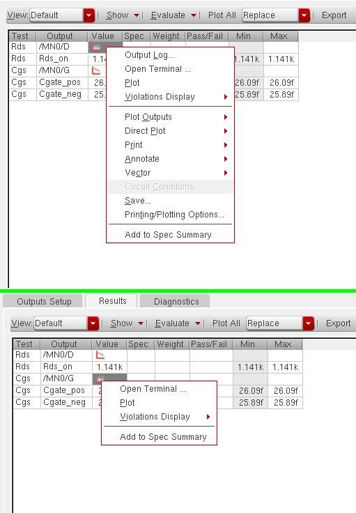

I'm using ADE 6.1.3 to run a couple of different tests on a circuit, and for some reason it behaves differently when I run more than one test at a time. As you can see in the attached picture, when I right-click on a result from the first test, it shows the normal menu with all options including "Output log". However, when I click on an output from the second test, most of the options have disappeared! When I run this second test on its own, I do get the full menu.
Am I doing something wrong here? Why are the options different when I run more than one test at a time?

    I've not seen this before, nor seen it reported before.
    You should contact Cadence Customer Support. I'm assuming you're using a recent subversion; if not, you might want to first try with the latest hotfix (latest is 6.1.3.500.14) to see if the problem still occurs - it may have been fixed, and I just searched using the wrong terms.
