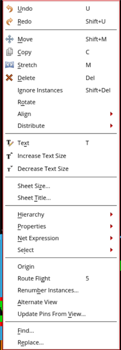

    BaaB over 6 years ago in reply to Andrew Beckett
    I don't see Edit -> Component Display anywhere. Is it removed?
    Andrew Beckett over 6 years ago in reply to BaaB
    Please don't post on 10 year old threads (see the Forum Guidelines).
    The old, horrible, Edit->Component Display form was replaced in IC616 with View->Annotations->Setup, which fixes most of the problems with that flow and has a lot more powerful control over the annotations.
