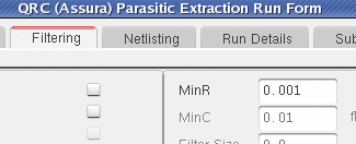

  • Quek
    Quek over 15 years ago
    Hi Stefano
    Please use minC option as shown below. As RCX is an outdated tool, please use QRC for parasitic extraction.
    Best regards
    Quek

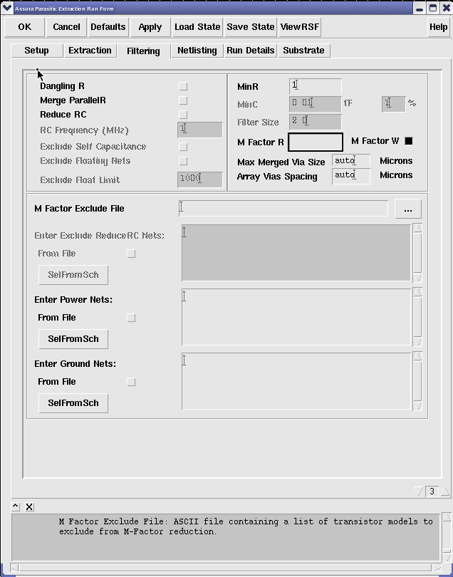

  • Ueue
    Ueue over 15 years ago
    Hi Quek,
    Thanks for answering.
    This option is not selectable (I don't know why).
    Thanks,
    Stefano
  • Quek
    Hi Stefano
    minC is meant for coupled cap mode. I guess you might be using decoupeld mode. Please change the mode to "coupled" and you should be able to use it.
    Best regards
    Quek
  • Ueue
    Thanks!
