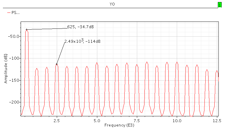

friends,
    I generated the PWM wave by giving a 1kHz sine wave of amplitude 200 mV(peak) at the positive input of an ideal VCVS and a 1V, 640kHz (peak-peak) triangular carrier to the negative input of the VCVS. Then I pass the PWM signal into a second order butterworth filter (using an SVCVS). When I probe the spectrum at the output of the filter, I see that the input signal is heavily distorted. Theoretically an ideal, continuous-time PWM (NPWM) is distortion-free. Am I missing some setting in cadence.
 The settings are:
VCVS gain : 10000
VCVS Min output voltage : 0
VCVS Max output voltage : 1
Strobe period: 1/(Triangle-freq*32)
Maxstep :  1/(Triangle-freq*32*16)
Reltol : 1e-4
Transient mode: Conservative
thank you in advance
    Andrew Beckett over 15 years ago
    If this is still an issue for you, can you post the input.scs ? This will save some time setting up an equivalent circuit (albeit simple) to the one you have - given that everything is ideal. Just helps those of us who answer on the forums answer more efficiently.

    terminator12 over 15 years ago
    Andrew, thanks for replying. Yes, the basic ideal structure is still problematic. Given below is the input.scs; The harmonics are just about 75 dB below the signal in the PSD plot. For an ideal PWM it should be atleast 150 dB even if calculated with moderate machine precision. However, when I design complicated closed loop systems involving PWM, the harmonics are well below 120 dB from the signal harmonic. Now I do not which to believe. Kindly help me out.
    here is the spectrum(PSD)
    The best thing would be for you to log a service request on this. I had a quick look, but to be honest don't have the free time to be able to dig into this in more detail to find out what's going on.
