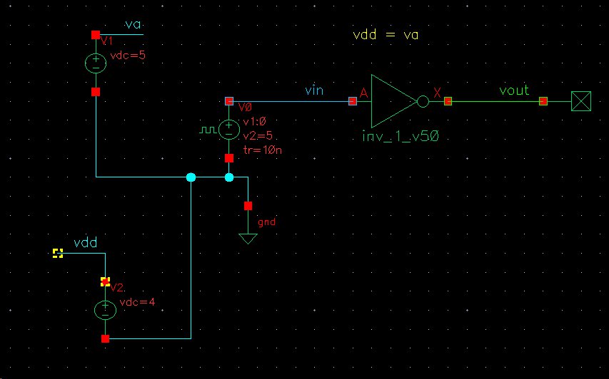

Is it possible to use a netset to redefine a global in a spectre model file?
webbyguy
webbyguy over 15 years ago
I have a symbol that has an input and an output.  It is an inverter with no supply connections on the symbol.  It is called inv_1_v50.  It is show on my simulation schematic that is attached.
I have a verilogA model of an inverter that is called bh60a_inv_min_nl.  It has the input and output ports, but also has the supply nodes.  Also the port names don't match between the two.  It's code is as follows:

I wanted to link the symbol to the verilogA with a model file such that I don't have to rewrite the verilogA code, or have to update the symbol (I have a lot of cells to do this on, and potentally I need to do it across a lot of designs).  Here is the model file I wrote:
//title
simulator lang = spectre
global 0 gnd! vdd
ahdl_include "/home/ffmygt/models/logic_models.va"
subckt inv_1_v50 X A
    //R1 (X A) resistor r=1
    I1 (X gnd! vdd A) bh60a_inv_min_nl
ends inv_1_v50
 I then selected this model file with the config view for simulation.  This works (in ams, but I can't make it work in spectre), but I am unable to apply a netset for the vdd node in the model file on my schematic.  I tried to netset vdd=va on the symbol (as shown in the attachment), but vdd in the model file still ends up connected to vdd on the schematic.
Is there some way to apply a netset to a global node in a model file?  Maybe there is some other syntax I should be using in the model file to pass the nodes not shown on the symbol?
Thanks
