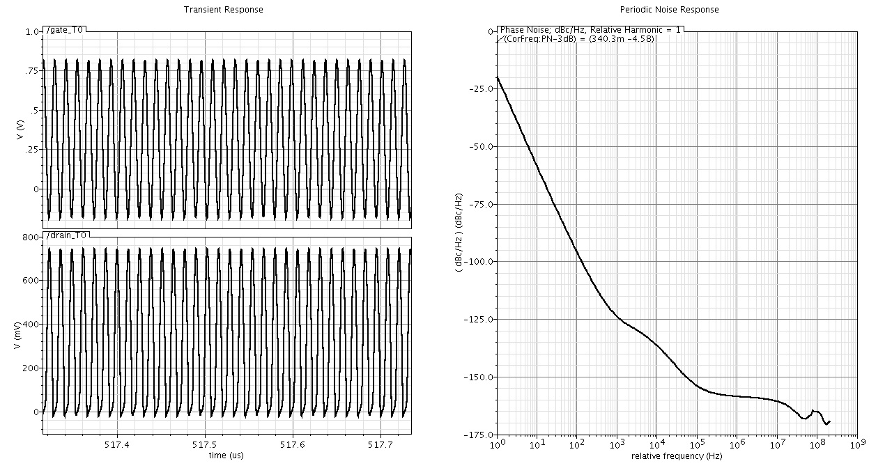

Dear all,
 I have designed a crystal oscillator, but some doubts still remain.
 Below please find the schematic attached (Pierce Oscillator).
1 - When analysing the phase noise a "bump" appears by the end of the curve (both in strong and weak inversion). What is the reason for that (file attached) ?
 2 -As the crystal is cut for 80 MHz, I use the samevalue for the beat frequency parameter. Is this correct ?
 3 - The biggest problem of all, is when calculating Jitter using PSS+PNOISE the results vary quite a lot due to the upper integration limit. How to set this correctly ?
 4 - Point 3 result's are so dramatic, that weak inversion, exhibits better phase noise results than in strong inversio. In terms of jitter is exactly the same .... I am interested in Jcc jitter.
Best regards,
Pedro Cardoso

    pcardoso73 over 15 years ago
     Anybody can help me, please ?
     On top of this I would like to ask, what type of PNOISE simulation should be used in a VCO (which will be on a PLL) PM or FM ?
     Best regards,
    Pedro
