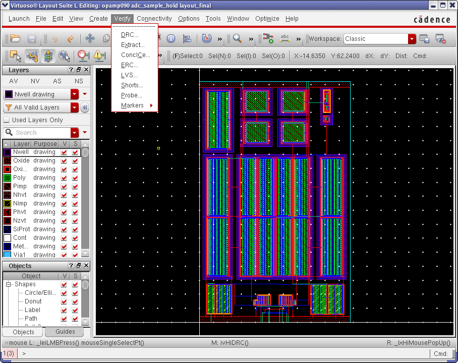

Is there a quick way to execute Diva scripts under the Oasis release?
Thanks in advance for the help.
Jon

     Cadence Oasis is the new data format for ... Cadence. Prev it was cdb
    The verify puldown is this release does not have "DRC"

    I think that you mean "Open Access" - Oasis is a data format that is similar to GDSII in use (e.g. Stream Out). The IC61x releases of Virtuoso use the Open Access database format.
    Lawrence.
    Lawrence beat me to it. It's OpenAccess.
    As for Diva, in IC6.1.5 it's there (see the screenshot). I vaguely recall it being omitted in some very old OpenAccess-based IC release, but I can't recall if that's true or not. What version are you using (it says this in Help->About in CIW)?
