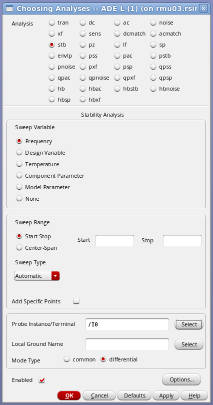

    Dear Sir,
    I am new in to the analog design, I started recently with the simulation of the fully differential amplifier. I used the Iprobe with the stability analyses and this method is working with me perfectly, however I am not of how to use it with the stability simulation of both the common mode and differential stability
    I would like to kindly show you the setup I am going to use and please confirm me if it is wrong or if there is other better setup than I showed
    Thank you in advance
    Differential mode stability test Common mode stability test
    Andrew Beckett over 7 years ago in reply to FormerMember
    Those pictures are too small to see what you you're trying to illustrate.
  • Frank Wiedmann
    Frank Wiedmann over 7 years ago in reply to FormerMember
    Your setups for the differential-mode stability test both look correct. Your setups for the common-mode stability test (incorrectly labeled "Differential mode test") also look correct. However, a simpler way would be to use the same setup as for the differential-mode stability test (with the diffstbprobe placed directly at the output of the amplifier, before the common-mode tap) and just select "Mode Type: common" (instead of "differential") in the stb setup form (see below).

    Why do you need to know the internal details? diffstbprobe is effectively two baluns which convert the differential signal into the common-mode and differential-mode part, have an iprobe in each path, and then convert them back to differential again. The simulator then knows which of the two iprobes to pick based on which mode you've asked to measure stability.
