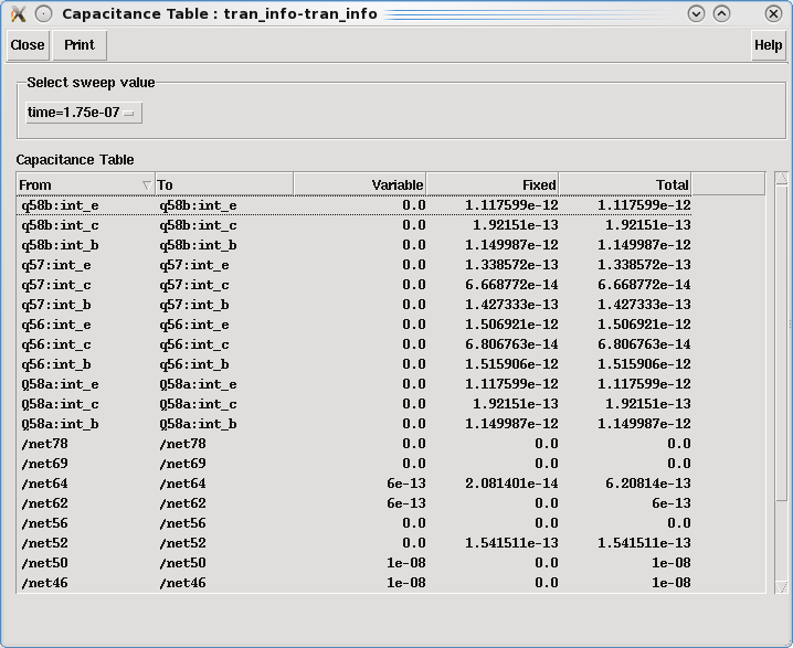

    Hi Andrew, yes, you are right. indeed, i use the spectre from ic5141, and as you suggested above, i changed the infoname,and it works well now,i can see the node capacitance in the output log file, but i can't use the results->print->capacitance table or plot the capacitance versus time from the results browser. there is no cap info in the results. did i miss some options?

    I just tried this with spectre from IC5141, and the problem is that spectre does not save the results correctly (the actual data seems to be missing). I ran in IC5141 with spectre from MMSIM10.1 - and then it all worked perfectly.
    So the solution is to not use an (almost) 8 year old version of the simulator, but to use something more recent.
    See this picture of printing the capacitance table in IC5141.

    Hi Andrew, thanks for checking this for me. and as you mentioned before, we can save the capacitance table into a file from spectre, and now, i want to plot these data in format of curves, so is it possible? is there some skill function can read the data perfectly and plot it as a curve. By the way, the data is arranged just as the capacitance table in your printing picture.
    Zfeng,
    Use Tools->Results Browser, and then expand the tran_info-tran_info results. You'll see results of the form "net1 : net2" (where the two may be the same - depends on the captab options you chose). If you click on these and expand, you'll see three entries Fixed, Total and Variable (say), and you can then either plot these or  send to the calculator. That might generate an expression such as:
     getData("net50 : net50:Fixed" ?result "tran_info-tran_info")
    If you plot this, it will be versus the timepoints in your infotimes parameter.
    The above was with wavescan as the waveform tool. If you're using AWD, you'd expand tran_info-tran_info and then click on sweepVariable, which will show "time". If you then click on one of the time points, and then go to the net pair name, click on that to see Fixed/Total/Variable, and then use the Middle Mouse button and pick "Expression" - you'll end up with an expression in the calculator such as:
     pv( "net62 : net62" "Total" ?result "tran_info-tran_info" ?resultsDir "/export/home/andrewb/demos/SpectreRF/simulation/ne600/spectre/schematic" )
    (You could omit the ?resultsDir if it's the current results).
    Either the pv() form or the getData() form will work in either calculator/waveform tool.
