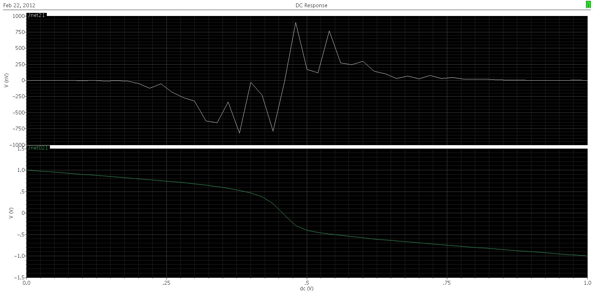

This is not a serious problem and found the solution through googling. Solution was to empty the maxnotes & maxwarns field which is found in simulator options (ADE->Simulation->option->analog->simulator options). After doing this, simulation ran successfully but got an illogical output. This is the serious illogical result which I am not able to resolve it. Details are given below.
First I tried with DC analysis (source voltage varied from 0 to 1v) and tried to plot DC response from both source voltage and as well as from the output of the inverter. I attached those results with this query.  DC response (first row in result) from THE SOURCE IS NOT A LINEAR CURVE AS EXPECTED rather response is of some kind of noise (though I didn’t select any kind of noise options). One thing to observe is that, voltage coming in Nano volts.  Output response is fine but it is sweeping from 1 to -1 as against the expected 1 to 0.
Secondly I tried with pulse voltage source from again analogLib but got into trouble again. Here again output response is fine but plotted source voltage is coming in terms of micro volts.
Can anyone explain, how can I resolve it? Is it because of simulator/mmsim/analogLib/maxnotes settings?

    The only way that I can see that you might have hit the first problem (using the IC5141 hotfix with the simulator run log not being generated) is if you have done the following:
    1. You have the SPECTRE_FEATURE_FILE UNIX environment variable set pointing to the MMSIM10.1 installation
    2. You have the <IC5141instDir>/tools/bin and <IC5141instDir>/tools/dfII/bin before the <MMSIMinstDir>/tools/bin in your UNIX path (e.g. $PATH env var if using bash/ksh/sh or $path shell var if using csh).
    Only if I do both can I get it to fail. This is because the IC5141 hotfix version looks for the feature file to detect whether the spectre version being used supports -maxwarns and -maxnotes on the simulator command line - the (very old) version of spectre that is shipped in the IC5141 installation itself did not support this. So what has happened is that you've overridden the feature file lookup mechanism to point to a specific feature file which tells it that it does support -maxwarns and -maxnotes, but yet are using a version of spectre (found first in your path) which actually does not - so spectre falls over in a heap.
    You should NOT specify SPECTRE_FEATURE_FILE yourself except in exceptional circumstances (if a Cadence AE tells you to in order to solve a specific, usually short term, problem, or for evaluating some special new feature). So please make sure that UNIX env var is not set.
    In addition, you should ensure that the MMSIM path is before the IC5141 path otherwise it will pick up the old version of spectre shipped in the IC5141 installation, which you don't want.
    The second problem is nothing to do with maxwarns or maxnotes. it's almost certainly that you have the circuit connected up incorrectly and (maybe) supplies are not connected. Either that or you've got the scale of the devices wrong. Another possibility is that you don't have the UNIX environment variable $CDS_Netlisting_Mode set to "Analog" - and so the netlist is missing out some of the default values.  Hard to tell given that you didn't show the actual schematic or netlist.
    What I'd suggest is that you try typing in the CIW cdsGetNetlistMode() and see if it returns "Analog". If it doesn't, you'll need to do:
    setenv CDS_Netlisting_Mode Analog
    or
    export CDS_Netlisting_Mode=Analog
    depending on whether you're using csh (in the first case) or bash/ksh in the second case, and do this before you start icfb. You may need to do a Netlist->Recreate in ADE after that to ensure that it recreates the netlist from scratch.
    If that's not it, I suggest you post the input.scs here (not the models, because they're not yours to post) - but quite likely it will be possible to see what's wrong (especially if this is a relatively simple circuit - you say it's an inverter).
    I'm having to do a lot of guesswork here...

    About first problem: In my script file, path for  <IC5141instDir>/tools/bin and <IC5141instDir>/tools/dfII/bin was mentioned above the <MMSIMinstDir>/tools/bin. So I changed it and now it works fine with the default maxnote and maxwarn values. You said rightly that old spectre version was considered. Even earlier I did not set any SPECTRE_FEATURE_FILE UNIX environment variable and also I failed to find it. As it’s already working fine just by editing the script file, it seems UNIX env variable is not necessary as per now.
    About second prob: Though connection and transistor sizing might be the problem, I was actually plotting the values of the voltage across ideal voltage source itself. So in this case, graph was supposed to be linear. I couldn’t sort out this problem (might be the connection problem but couldn’t find) and hence I created a new cell view and I drew the same circuit again. With the new cell view, I am getting the exact output what one can expect. Thanks again Andrew.
