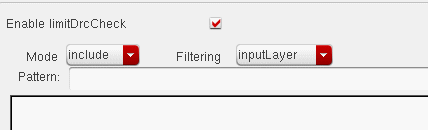

I am using Assura for physical verification (with IC61). It would be very helpful, I anybody can let me know, a way where I can check only few selected DRC rules instead of full DRC checking..

    Please use the limit drc check function at the bottom of the drc form. : )

       I have the similar doubt on it. "Enable Limit DRC" can only used to limit rules based on layers.I have 200+ DRC rules and they are classified to different classes based on the priority. Suppose, I want to run a particular class of DRC rules. Is   "Enable Limit DRC"  can perform the same or any other way I can perform this?

    Assura's "Limit DRC" function can be used to limit the number of DRC rules based on input layers, output layers, message and cmd. You can refer to $ASSURAHOME/doc/assurauser/assurauser.pdf for more details.
