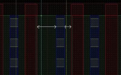

 I wanted to connect two transistors using abutment.
 abutment

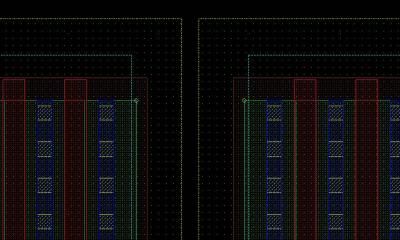

The problem is that virtuoso doesn't reduce diffusion from one side, as you can see it in the next picture, but for matching i need the same length from contact to gate.  What should i do?
abutment

    Hi Alex
    I think this looks like a pcell issue. Perhaps it might be better to first contact the foundry about it.
    Best regards
