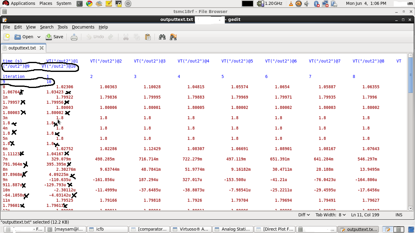

Hi everyone!
I do monte carlo analysis for my circuit via oceanScript but when i use ocnprint("./filename" out2 ?step 10n) the output text file is something like that I attach, note that when I remove the ?step the the output data is printed in one column an so I don’t have any problem but for above command the printing format  changes and the written data is not clear. What I  do for solving this problem?
    I tried it, to make sure we're talking about the same thing.
    Without ?step, the x-axis for each transient run will be different - the timesteps will not be consistent. So because of that, it can't print them in a big horizontal table; it has to do each iteration in a separate pair of time-value columns.
    With ?step, the x-axis will be consistent - so it does long lines. In your case your editor isn't wide enough and so it appears to line wrap - but with a longer width, it will be clearer.
    You could pass the ?numSpaces 0 argument, or adjust the ?width or ?precision to get more compact formatting.

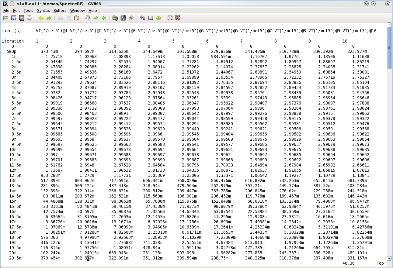

    For example, see the screenshot of my text editor - it's wide enough (and I used ?numSpaces 0 to stop it getting too wide):
