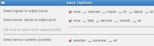

 Hi Sir/Madam:
 I'm taking a long transient simulation in Cadence Spectre, the simulation is to calculate the BER(bit error rate) of a transistor-level circuit.
Because I have a symbol which is written in Verilog-AMS to calculate the BER and store the result in a text file outside, so I don't need the cadence to store any simulation result. I have done:
1. In ADE XL Test Editor,  =>Output=>save all, I unclick all the selections (save nothing), and click OK
But at last,  a file named "tran.tran" will be still saved in "~/cadence/simulation/***/adexl/result/data/Interactive.0/1/***/psf", and this file in my simulation will be as large as about 600Gbit (after only 1-day simulation, and the data is still not sufficient for me); the cadence then will say it "face a fatal error" when writing data to "tran.tran" file, there is not enough space to store the data.
 I even deleted the "tran.tran" file when the simulation started, but the problem was still there.
Could anyone help me with these:
1. Why cadence still saves the transient data even thought I have selected "save nothing"? Did I make the wrong setup?
2. Is there any method can be taken to let cadence  just do the simulation but save no simulation data?
I'm very appreciated for your help! I've trapped myself in this problem for days! Thank you very much for any help!
  • Quek
    Quek over 14 years ago
    Hi ccarrot
    To prevent saving any signals, you can select "none" instead of not selecting any of the choices. If none of the choices are selected, the signals which you have specified in "Output setup" will still be saved.
    Would you please try it and see if it resolves your problem?

    Thank you very much Quek! It works! Now the size of  "tran.tran" file is significantly reduced!

    Note that not having any of the choices checked on the save options form means that it will pick the simulator's default, which is "selected". With spectre, "selected" means that any signals that appear in save statements (ie those outputs explicitly saved in the Outputs pane) will be saved as Quek mentioned; if no outputs are explicitly saved then it will save _all_ node voltages (well "allpub" node voltages). This is to keep things simple - if you didn't tell it what to save, it assumes you wanted to see something, so it saves the most likely which is all voltages.
    So that's why you need to explicitly pick "none".
