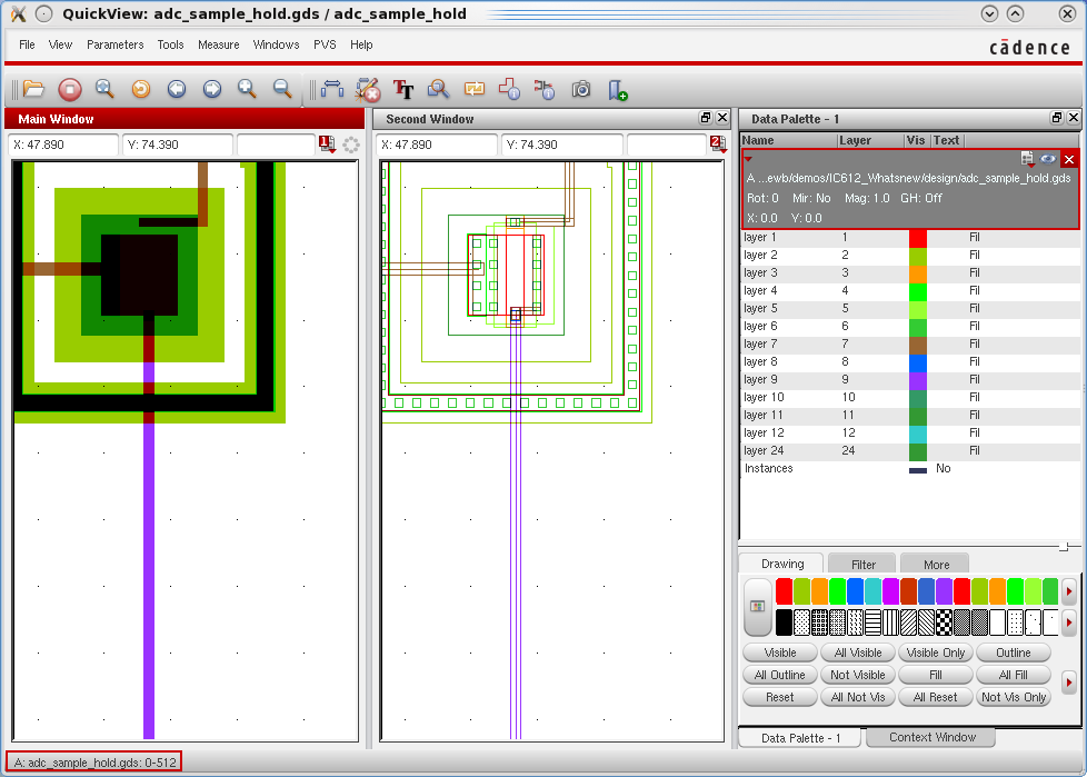

 I've noticed the function "Fade Overlap" of QuickView would
  be usefull when comparing two layout data DEF for rough visual
  check,
 since we used to convert DEF to GDSII and run other layout tool
 for XOR operation.
Question
 Most of wire have no width segment in Quickview layout
 window (No solit pattern), but from unknown reason some
 of wide wire have correct width.
 I assumed both DEF and LEF have no error, since both file
 can be displayed solid pattern by other DEF/LEF viewer.
 How can I make Quickview show those no width segment.
Environment
 QuickView 11.1.1 HF2
 Test DEF, LEF version : 5.6 and 5.5
Best regards
    Andrew Beckett over 13 years ago
    I don't really understand your question. Did you set the layers to have a solid fill in the palette? The Help for Fade Overlap explains that the fill patterns must be solid...
  • Teru
    Teru over 13 years ago
    Thanks for your quick reply.
    At this moment I didn't use the function "Fade Overlap".  Before using "Fade Overlap" I want to show layout pattern as is, solit pattern. Now I see layout pattern with 0.4um width as just line in Quickview layout window.
    Best regards
    In the attached picture, the Main Window is where I've hit the "All Fill" button at the bottom of the palette, and the Second Window is using a second palette where I've left everything as outline.
    If it's not showing tracks as  in the Second window, maybe something went wrong with your conversion of DEF to GDSII? You didn't say how you did that - so it's rather hard to help you - too little information in your post, unfortunately.
