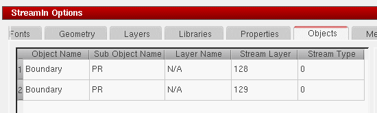

  • Quek
    Quek over 13 years ago
    Hi bjbit
    That's not exactly what I meant.You can map them to prBoundary objects using the "Objects" tab in the stream-in form. Please see the picture below. The reason for this mapping is that we need the prBoundary to be created as an OA object in the database so that it can be recognized by various tools such as floorplanner, export-LEF, analog placer, etc. The prBoundary in IC5141 is simply a rectangle but this is no longer correct in IC61.
    Best regards
    Quek
