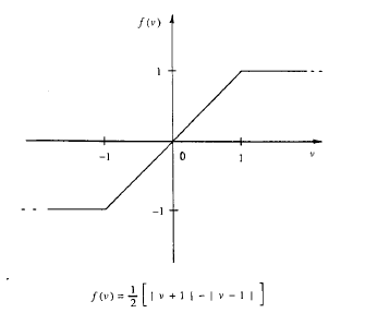

// VerilogA for Chua12, VxijwithFile, veriloga
`include "constants.vams"
`include "disciplines.vams"
module VxijwithFile(x,xij,gnd);
inout x,xij,gnd;
electrical x,xij,gnd;
real parameter c=1e-9,r=1e3,I=0,Vx0=1;
integer mcd,retval,count,f;
real Vykl[1:9],a,vx,A[1:9],Vxij[1:9],Avy[1:9],sum,v1,v2,t;
branch(xij,gnd) ij;
genvar i;
analog begin
   mcd=$fopen("/home/Documents/scanftest.dat","r");
      retval=2;
      count=1;
      sum=0;
      while(retval==2) begin
         retval=$fscanf(mcd,"%f, %f",a,vx);
         A[count]=a;
         Vxij[count]=vx;
         Vykl[count]=0.5*(abs(Vxij[count]+1)-abs(Vxij[count]-1));
         Avy[count]=A[count]*Vykl[count];
         sum=sum+Avy[count];
         count=count+1;
      end
$fclose(mcd);
       f=0;
      for (i=1;i<10;i=i+1) begin
       f=f+A[f]*Vykl[f];
       end
v1=exp((t-c*r)/(r*c))*(f/c);
v2=idt(v1,0,10e-5);
V(x,gnd) <+ exp(-t/(r*c))+v2;
//I(xij,gnd) <+ sum;
end
endmodule

    Sali over 12 years ago
     Thank you so much for your help, actually I want to simulate the circuit which has three voltage controlled current sources ,one of them has the equation in the attached figure since it is the main source for the other dependent sources.
    I should receive the result as in the second figure
