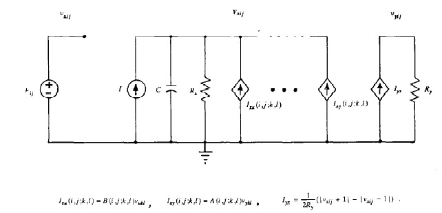

Dear all,
I need your help to how to finish this simulation I spent a lot of time learning VerilogA and the way of creating new models in Cadence
My circuit that I need to simulated it in Cadence is
At the begining I tried to model three separate sources and connect them together in the schematic but it fails to simulate, then I tried to write all model in one cell view and connect it to the rest of the circuit, here I coudn't continue and I don't know how to connect it.
The schematic is in the following figure:
The transient analysis:
The verilogA code is :

    At the begining I wrote three separate codes for the three voltage-controlled current sources and created three symbols for them but when I connect them with the capacitor and the resistor it seems that the voltage at node x has a zero value.
    Those three codes are simply the equations indicated under the circuit schematic in Fig.1.
    After I put the code inside one symbol and connect it to the rest of the circuit, it gave me the previous error.
    I'm using data comes from an external data file.
    If I remove the // at the end of the code another error appears and it says that the function I is not defined
    If you need any further information please let me know.

    I simplified the circuit and removed the dc sources and still receiving the same error, although my final goal is to keep the three voltage controlled current sources separated and two of them(Ixy and Iyx) receive its input from the first one(Vxij)

     First of all, the line:
     real parameter c=1e-9,r=1e3,I=0,Vx0=1;
    Is the reason why the I() function doesn't work. You have defined a parameter called I, and these clash. Since it doesn't appear to be used, either rename it or remove it.
    The equations refer to a real number t, which is not set - so this will be 0. I'm not sure if that's important.
    Debugging the convergence issue is hard since you didn't provide  scanftest.dat. If you don't want to provide that, if you add:
    $strobe(f,sum)
    after you've computed the value of f, that would be sufficient.
    The code is also reading the file on every iteration, which seems a bit excessive to me... probably a good way of slowing down the simulation (once it converges).

    I'll take a look at the example with the coefficients you've provided later, but the last point about t is that you have these equations:
    v1=exp((t-c*r)/(r*c))*(f/c);
    v2=idt(v1,0,10e-5);
    V(x,gnd) <+ exp(-t/(r*c))+v2;
    These expressions use a variable t, which is not set anywhere in your model. So it will be 0 in all the expressions. It's not clear to me what you were expecting, but I assume you didn't really want it to be 0 all the time? I'm not sure what you are actually expecting it to do...
    There are also a couple of cases in your code where you are getting array bound violations. The first is in this section:
    while(retval==2) begin
             retval=$fscanf(mcd,"%f, %f",a,vx);
             A[count]=a;
             Vxij[count]=vx;
             Vykl[count]=0.5*(abs(Vxij[count]+1)-abs(Vxij[count]-1));
             Avy[count]=A[count]*Vykl[count];
             sum=sum+Avy[count];
             count=count+1;
          end
    Well, this will go around the loop after the 9th read having incremented count to 10. No major harm will happen though on this one.
    The second is in this loop:
            f=0;
          for (i=1;i<10;i=i+1) begin
           f=f+A[f]*Vykl[f];
           end
    Are the array indices supposed to be [f] ? If so, this breaks because the arrays start at 1. Not sure whether f will overflow too. Was it supposed to be [i]?
    I suggest you correct the basic things first and then see what happens.
