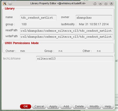

 I met a problem that I can't modify the properties of all the libraries. Every thing is grey. How to make them editable?
The version I am using is IC615
Thank you!
     None of those properties are editable (some are attributes, and techLibName is only settable by using the CIW->Tools->Technology File Manager->Attach UI). You should be able to "Add" new properties though - did you try that?
    It's not that clear what you were actually wanting to change.
