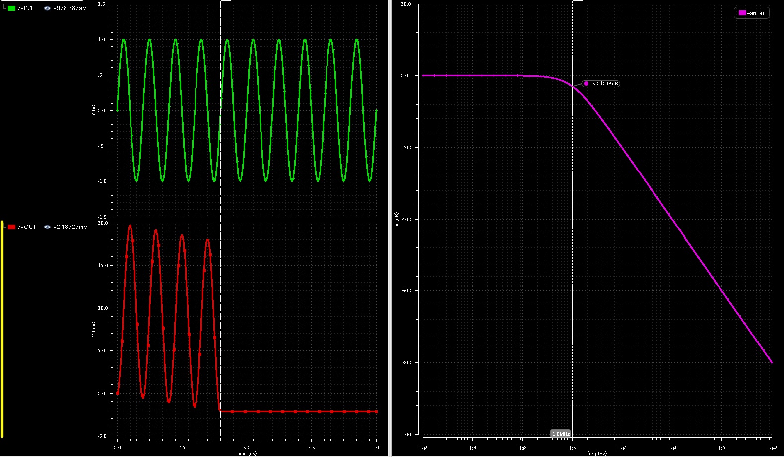

Hi all! I am experiencing a problem when trying to use the "sp2tswitch" in a transient simulation where I use the "actimes" option to perform multiple small-signal analyses at different time instants. In a nutshell, it seems that the "sp2tswitch" component remains "stuck" in the AC position after the first "actimes" call, and does not return to its "transient" position for the rest of the transient simulation.
I have prepared an example test case (please see attachments below). I have a first sinusoidal source (f=1MHz, A=1V) that should drive a cap (C=1pF/(2pi)) through a 100MOhm resistor for the transient simulation, and a second source (Vac=1V) that should drive the same cap through a 1MOhm resistor but ONLY FOR THE AC simulation. If I run the AC simulation without embedding it within the transient simulation, I obtain the expected output voltage ("vOUT") for both simulations, transient and AC. However, if I embed the AC simulation within the transient simulation at actimes=4us, the switch remains in the AC position for the remaining of the transient simulation, providing erroneous transient results from this instant onwards! (the AC simulation results are however correct).
In my actual application, I use the "sp2tswitch" repeatedly in order to selectively break feedback loops during small-signal analyses (AC, noise, stb) while retaining them closed for proper transient operation. In the past I never had issues with this approach, but I didn't have the need of running the small-signal analyses more than once. Now I need to do this, so I would really appreciate if someone could please help me to overcome this problem.

  • dontpanic
    dontpanic over 11 years ago
     [simulation results for test case - note erroneous transient output (vOUT) after the "actimes" is executed at t=4us]

     I've tested this with spectre 13.1.1.205.isr10 and it works correctly. I didn't find a specific report of this issue which was fixed, so I'm assuming it was fixed as part of something else.
    Hi Andrew! Thanks so much for your reply. The latest Spectre version I have access to is 13.1.0.186.isr5 64bit (12 Mar 2014), and unfortunately it still displays the erroneous behavior. I'll see if I manage to get the 13.1.1 release installed at my workplace in order to bypass this issue.
    Cheers,
    Jorge.
