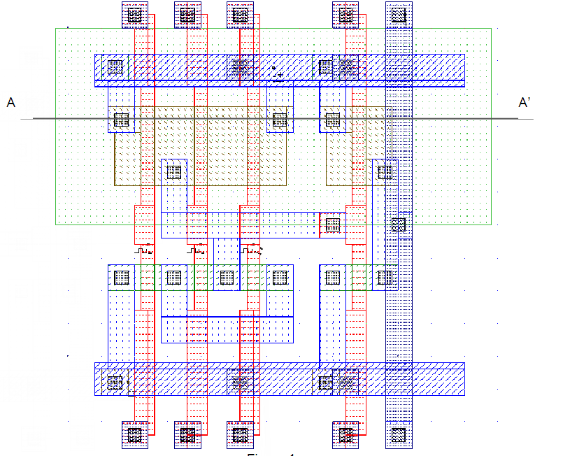

I'm a Microelectronics student and I'm in a struggle to understand which logic function is associated with the following layout:
It says that the circuit has four inputs (A and B) and one output (y), in an N-WELL TECHNOLOGY.
Thank you very much in advance and I'm sorry for my basic question for you

    Hi Goncalo,
    this layout represents a so-call complex, or a compound logic gate
    It looks like a ORAND gate followed by an inverter. (I hope I got that right)
    That is, a 2-input OR gate feeding a 2 input AND gate The output of the AND gate is inverted
    These gates are used because it can save space.
    If you know the cellname of this layout, the function is probably contained in it's name (eg 21OAI perhaps).
    Do a search for complex logic gates using the string AOI and OAI in your search.
    Hope this helps

    Hello Colin and thank you very much for your help! I was wrong regarding the inputs, it will have 3 inputs.
    I've searched a bit and I think this is a 3 input AOI. If it is a 3 input AOI, this one will be a 2 input AOI am I right?:

    ColinSutlieff over 11 years ago
    The black and white example is a simple 2-input NAND gate followed by an inverter (So, a 2 input AND gate).

    I was just about to reply the same as Colin - the last example appears to have an inverter on the left, but the outputs is not connected. The lower middle nmos has the source floating - and the source of the top middle pmos is connected to the a input. It's very odd and doesn't appear to be anything useful.
    BTW, it should be pretty straightforward for you to draw out the schematics for these, and they are quite easy to recognize once you've done that... At the very least, you could write out a truth table (or even just simulate them) to work out the function.
