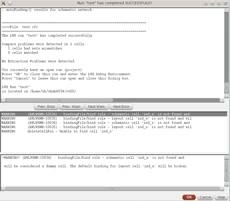

gpdk045 inductor LVS
analogy
analogy over 11 years ago
So I was running LVS in a circuit with inductor and running LVS (gpdk045 version 2.0), I got this error :
Where are rule files for ind_a and ind_s of gpdk045 ?
    I've not checked the current version of the PDK, but I suspect this works nowadays. The version you are using is very old - I had v3.5 of gpdk045 installed on my laptop for ages, and the current version is v4.0. So I'd strongly suggest getting the latest version from  - you may need to find the person at your school who is responsible for the Cadence program because this site requires a support login.
    If after trying the latest version of the PDK you still have a problem, let us know and I can investigate (sorry, this is just a matter of time - my default assumption is that this is likely to have been fixed by now).
