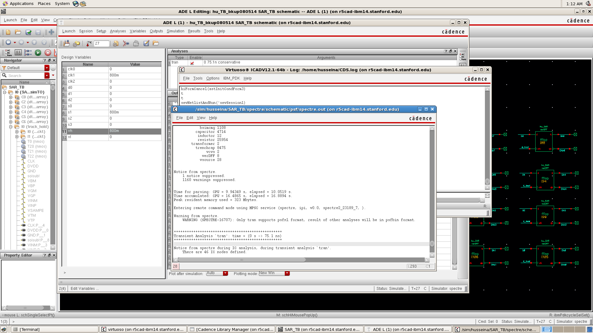

I am simulating a large circuit using spectre in cadence ICADV12.1,
The simulator stops at the first step in simulation without giving me any error (as shown in the attached screenshot)
It remains like this long time (during which the simulation is running) and then aborts the simulation without giving any warning/error or anything to debug,
Should this be related to convergence issues ? Is there something I can check to debug this issue ?
thanks,
Hussein
    Dependent upon the version of spectre you're using (you'd need MMSIM13.1.1 or later), you can go to Setup->Environment and add +diagnose in the userCmdLineOption field. That may give you some clue.
    It might be convergence related, or maybe the simulation setup is wrong. Hard to tell from just a picture.
    I would suggest you contact customer support so that we can take a look.
