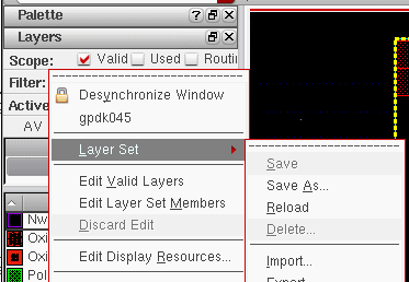

    Quek over 11 years ago
    Hi RFStuff
    You can load layer sets in IC616 as follows:
    a. Right mouse click in the layer palette to display the right mouse menu
    b. Go to "Layer Set->Import"
    Best regards
    Quek
