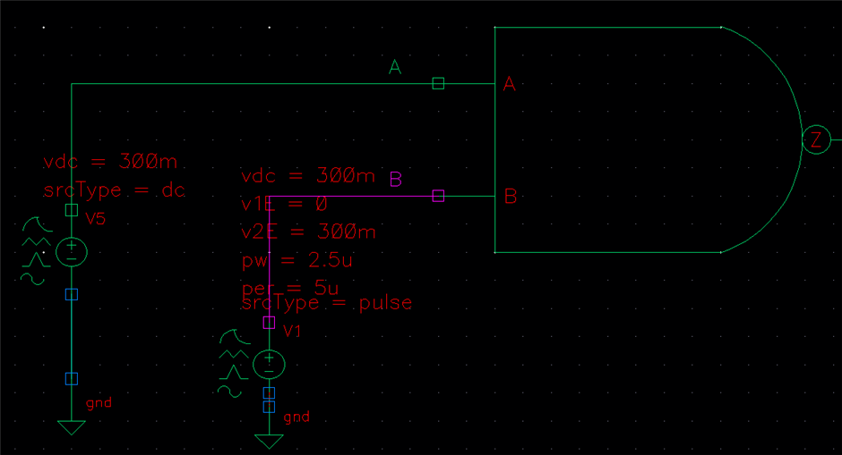

Hi there,
in my testbench I want to characterize a NAND2 circuit at a voltage level of 300 mV. While dc analysis is working fine, the transient analysis behaves strange. The input signal on port B always has a voltage level of 1 V but is set to be 300 mV. Have a look at the netlist generated bei ADE:
I1 (A B OUT 0 gnds! vdd! vdds!) NAND2_X1
V1 (B 0) vsource dc=300m type=pulse delay=-1.25u period=5u rise=10n \
        fall=10n width=2.5u
C0 (OUT 0) capacitor c=4f ic=0
V5 (A 0) vsource dc=300m type=dc
V3 (vdd! 0) vsource dc=v_vdd type=dc
V2 (vdds! gnds!) vsource dc=v_vdds type=dc
So as you can see, V1 does not contain val0 and val1 parameters. Maybe this is a "feature" of IC 6.1.6-64b.500.8 or am I missing something out here?
Marten

    marten over 10 years ago

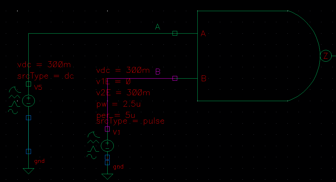

    Hi Andrew,
    thanks for your reply. Since I want to run a dc and a transient analysis in the same testbench, I do have specified the voltage 0 and voltage 1 inside the testbench schematic:
    And this is an excerpt of the generated netlist:
    I0 (A B OUT 0 gnds! vdd! vdds!) NAND2_X1
    V5 (A 0) vsource dc=300m type=dc delay=0 period=5u rise=10n fall=10n \
            width=2.5u

    So why is V1 generated without val0, val1?
    I suspect you're using an analogLib which isn't from Cadence. The vsource component in our analogLib doesn't have parameters v1E or v2E - maybe this is for another simulator (Eldo?).
    Can you check the path to your analogLib - perhaps you can change to use a Cadence-supplied version.
    Alternatively, you might be able to use Options->Tool Filter to ensure that parameters relevant for spectre rather than the other simulator are shown?
  • marten
    Hey Andrew,
    thanks a lot! Our cds.lib sourced some other .lib-Files, that redefined the analogLib and used ELDOs libs instead.
     I fixed this and now simulation is running as expected, thank you.
