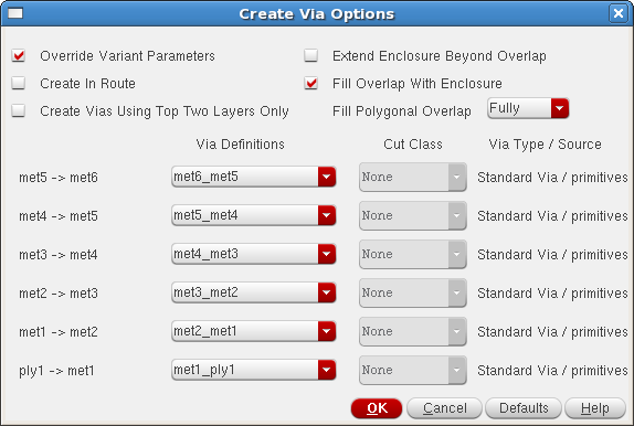

    I don’t see the option in the options tab to edit the cut spacings. Please see SS attached. Maybe I am on an older version of the tool?
    Brian.

    Hi Brian,
    you didn't mention your software version.
    But I have checked and can see that these features are new and not yet fully tested.
    The feature has been disabled by default.
    If you want to test it you can put the following in your .cdsenv file
    layout lmpiModeOn boolean t
    If you see any problems with the flag enabled you will need to contact customer support.
    Regards
