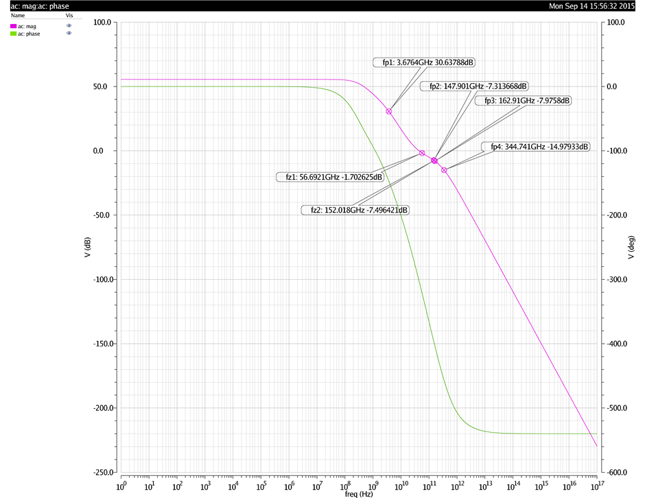

I have a simple 2-stage OTA (without any compensation) and again getting results which absolutely do not make any sense.
pz analysis tells me:
PZ Analysis `pz'
DC simulation time: CPU = 0 s, elapsed = 679.016 us.
                      Poles (Hz)
           Real                       Imaginary                 Qfactor
   1   -3.67643e+09                  0.00000e+00              5.00000e-01
   2   -1.47901e+11                  0.00000e+00              5.00000e-01
   3   -1.62910e+11                  0.00000e+00              5.00000e-01
   4   -3.44741e+11                  0.00000e+00              5.00000e-01
                      Zeros (Hz)
                      at V(vop,vom)/V3
   1    5.66921e+10                  0.00000e+00              -5.00000e-01
   2   -1.52018e+11                  0.00000e+00              5.00000e-01
Constant factor =  8.36594e+25
DC gain =  5.98046e+02
This is result of ac analysis (with the points from pz annotated):
Can this really be? This looks perfectly inconsistent to me. How can there only be one dominant pole which is above all much too high?
Based on hand calculations using values from dc op analysis (gds, Cdd and Cgg) I get the pole from the first stage as 1.054GHz, from the second stage as 990.2GHz.
I tried tweaking options for pz analysis but there are not really any useful options (like accuracy).
Thank you!

    Something strange appears to be going on. I suggest you contact customer support so we can take a look. Not sure if you've set any options to do pole-zero cancellation? Maybe seeing the pz analysis statement from your input.scs might give a clue?
    What happens if you pick method=arnoldi instead of the default method=qz?

    Thanks Andrew. I use cancellations but whatever options I choose the results do not differ. The pz statement is not spectacular, the last part of the netlist looks like:
        tnom=25 scalem=1.0 scale=1.0 gmin=1e-12 rforce=1 maxnotes=5 maxwarns=5 \
        checklimitdest=psf
    dcOp dc write="spectre.dc" maxiters=150 maxsteps=10000 annotate=status
    dcOpInfo info what=oppoint where=rawfile
    ac ac start=1 stop=100P dec=100 annotate=status
    pz ( vop vom ) pz iprobe=V3 freq=1
    subckts info what=subckts  where=rawfile
    saveOptions options save=allpub subcktprobelvl=2
    Using the arnoldi method, results are different but still weird: Now I get a dominant pole at 290 MHz which makes a bit more sense to match with the ac analysis. However, there should still be two closely spaced poles at 1 GHz:

    As I said, I think you'll have to go via customer support as we'll probably need to see the testcase that shows the problem to fully understand it.
  • itos
    itos over 10 years ago
    Thanks, I submitted over a Cadence support.
