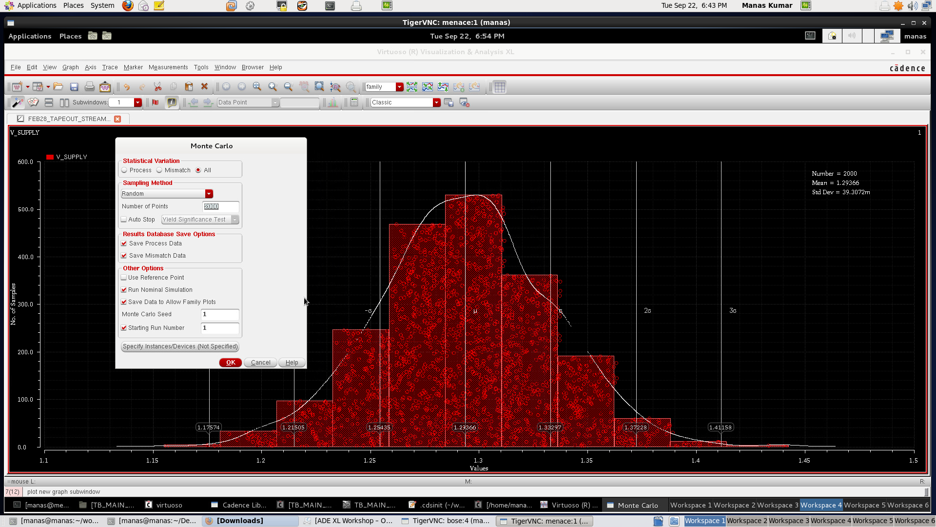

    Dear Andrew,
    The IC version is  sub-version  IC6.1.6-64b.500.7.
    Yes, that is ON. I have attached the snapshot of that setting.
    This seems to work for me OK in that subversion. You have to ensure that the simulation has actually started before you can look at the output log. There's actually no need to turn on the save family data for this bit to work (I tried without) - that only affects whether it keeps the actual waveform data or discards it during the run.
    If this is not working for you, I suggest trying with a later subversion, and if that doesn't solve it, contact customer support.
