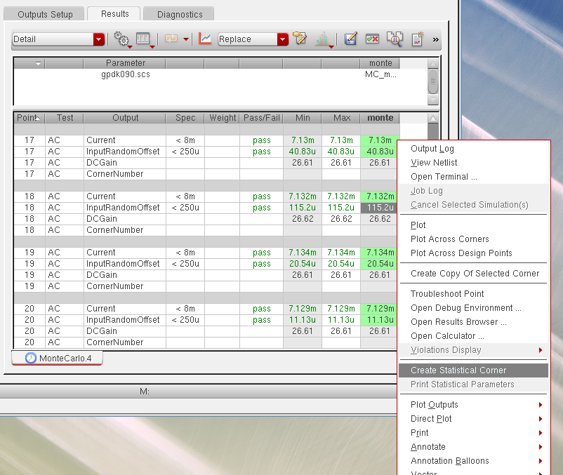

Dear All,
I ran a Montecarlo-Simulation with 5000 runs.
I also found the two worst case runs ( run no # 3042 and # 267).
I then want to run only the same two worst runs.
Could anybody please tell how I can do that.
Kind Regards,
    You can do this with Create Statistical Corner. On the Detail view, go to the points that you want to re-run, and use the Right Mouse Button menu over an output for that point and pick Create Statistical Corner:
    This will add a new entry into your Corners. You can do the same again for the other point. Alternatively you can use a similar right mouse button  menu over an output in the yield view to pick the worst point, or a percentile point (e.g. the 95th percentile).
    Then switch to Single Run Sweeps and Corners and run the simulation and it will just run those monte carlo points.
