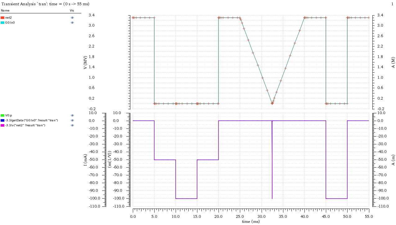

    Andrew, I am using the vcr method and I noticed that the vcr does not like voltage ramps. When I apply a voltage ramp to the vcr it treats it as a step (for instance I want to ramp from 1mV@0s to 1V@1ms translates to X ohms from 0s to 999us and then a jump to Y Ohms @ 1ms). Do you have any idea of what I could do to fix this? (I have tried to change my time steps but it does not change anything.

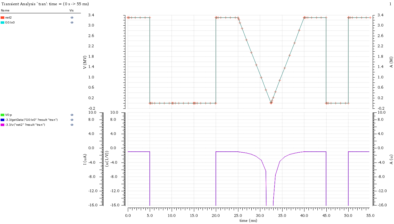

    Hi Nicolas,
    Everything is correct here. It's because you have a linear sweep on the controlling voltage and hence a linear sweep of the resistance - and so if you're plotting the current, that will have a 1/x response on that linear sweep.
    I added save G0:oppoint to the netlist so I could plot the G0:lx0 parameter (and hence see the resistance changing). I then computed (in the calculator) both -3.3/v("net2" ?result "tran") and -3.3/getData("G0:lx0" ?result "tran") and plotted these. You can see that these two calculated currents overlay exactly with the current from the simulator. The top strip shows both the controlling voltage and the VCR value (the lx0) - again, they overlay exactly.
    Here's a zoomed in (in the y-direction) plot of the current - you can see it is gradually changing:
    This is not surprising - if you see the last red cross (at this zoom level) before the end of the ramp down, it's at about 0.5MV, which corresponds to 0.5MOhm in the VCR. Then the current will be 3.3/0.5M which is about 6uA. The scale of the current means  you hardly see this change. If you were to change the y-axis to a log scale for the current, this would be much more evident without the need to zoom in.
    So everything is working as it should - the results are correct.
