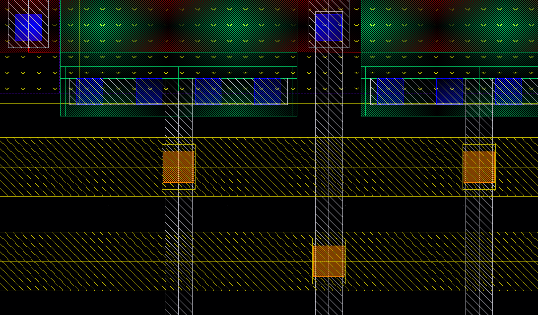

I have a few questions regarding routing using the modgen, pintotrunk and the .extras file
I have pasted an example .extra file which i use in my design for routing a differential pair
pin_taper_net v- v+ net65 net67 net73
pin_taper_wire_percentage 10 10 100 100 100
pin_taper_via_percentage 30 30 100 100 100
pin_staple_net net65 net67 net73
pin_staple_layer MET2 MET2 MET3
pin_staple_net v- v+
pin_staple_layer MET1 MET2

1) where can i find more documentation on how to implement the .extras file  with more options. for e.g i cannot find any documentation wrt trunk_net / route_preference_net in the cadence documentation.

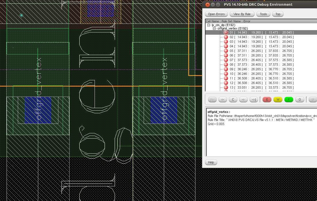

2)  When i use the above extras file for routing of my differential pair transistors, I end up with off-grid errors for the routing part of the pin to trunk routing. Other structures such as current mirrors  etc do not give me these errors.
  I can provide the relevant info if needed regarding these errors.
3) Also using the pin to trunk routing and extras file i see that the "vias" placed during routing have only one instantiation. If i need 2 vias at every point how do i go about preparing the routing details. While loading the extras file in the modgen there is an option to slect the type of routing  e.g virtuosodefaultroute / taperedroute etc. How can we use these options efficiently in routing.
For some reason there is not much info about these in the documentation. Or am i missing something here!
Any pointers will be very helpful!
Thanks!
