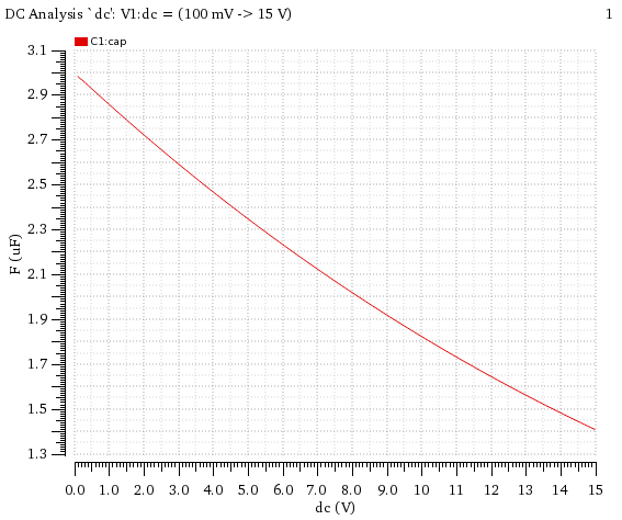

    mbchang over 10 years ago
    Andrew,
    Thanks for your reply. I did the following and I want my cap clamps at 2u. But somehow when I looked at the result, it didn't do the clamp part (on the left of the plot, the min goes to 1u).
    Any ideas?
    thanks,
    jerry
    model mycap capacitor min=2u coeffs=[-0.048 9.7e-4 -8.73e-6 2.91e-8]
    Jerry,
    I can't see your picture, but I tried this:
    // test min and max
    model mycap capacitor min=2u max=2.7u coeffs=[-0.048 9.7e-4 -8.73e-6 2.91e-8]
    C1 (n1 0) mycap c=3u
    V1 (n1 0) vsource dc=1
    save C1:cap
    dc dc dev=V1 param=dc start=0.1 stop=15 step=0.1
    (I set max as well to see if the problem was just the minimum). I get this:
    So I too see that it's not limited by the min and max. Probably best if you report this via customer support, but I filed CCR 1545206 for this issue.

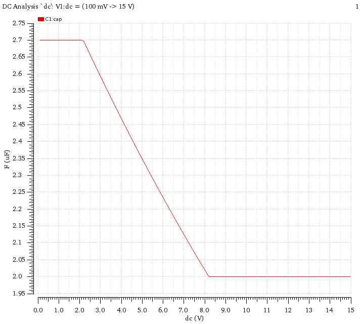

    Just to let you know that this has now been fixed - it will be in the MMSIM15.1 ISR4 hotfix, due out on approximately 8th April. Here's what the curve looks like now (I just tested it):
