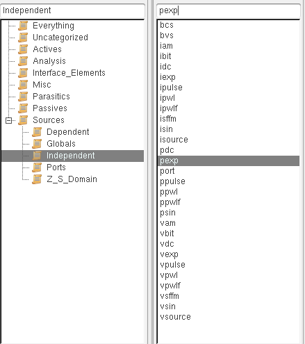

    ...spectre only has three independent sources: vsource, isource, and port. Various aspects of these are made available in analogLib in Virtuoso by other components, but they all netlist to one of these sources.
    Yes. I see a lot of independent sources in analogLib and they are really confusing.

    How about the DC offset? For example in vsource, source pwl, there are two DC components (DC voltage and DC offset). Is DC offset also used in DC analysis?
    For time-zero value, could you explain what does it mean? Does this mean the value of the source at the time equal to zero? Sorry English is not my native and I can't decipher that.
    I'm not really sure why the analogLib components are confusing. Part of the reason they exist is for other simulators and for historical reasons. With spectre you can just always use the analogLib vsource, isource, and port components - these have a parameter which defines the type of the source and fields which change dynamically.
    The dc offset (which corresponds to the offset parameter on the source) is not affecting the DC operating point. It just adds that offset to all the points defined in the PWL vector during the transient.
    For any time-varying source, the time-zero value is whatever value that time-varying waveform would have had at time=0s. So if you have a sine source with a sinephase of 90 degrees, it will be the value that the sine wave has at a phase of 90 degrees (since that's the initial phase of the sine wave).
