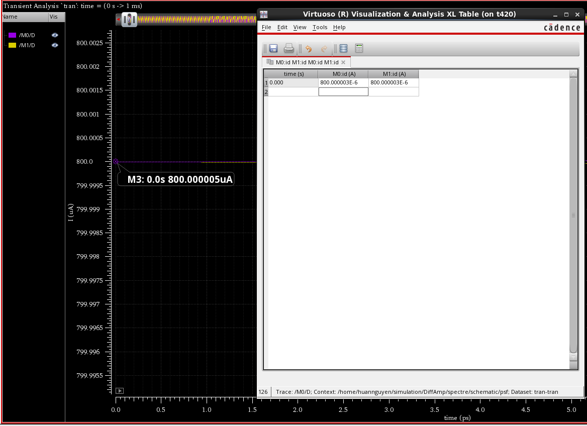

    What I see the difference is currents through M0 and M1 in two cases.
    DC analysis: iM0 = iM1 = 800.026uA
    Tran analysis: iM0=800.002uA and iM1=799.999uA
    I got this by running each analysis separately and then from ADE print operating points.

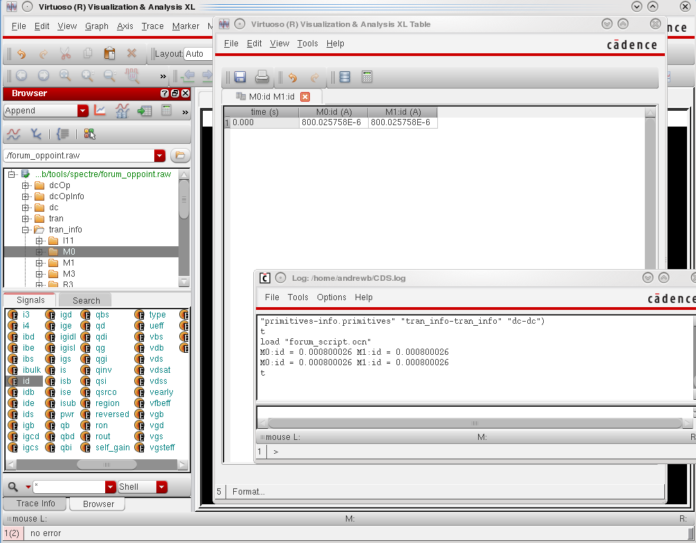

    How can I save the operating point at time 0 in transient analysis? I tried to put 0 into infotimes box but that doesn't work.
    I can't remember which IC version you're using, but I ran the simulation using MMSIM13.1 Update - which is 13.1.1.049. I then used the IC616 base release (I think it was an early IC616 ISR you were using). I found in that release, the infotimes output is in a result called "tran_info" and I can't plot the waveform (it is a single point waveform) but I can send the results to a table.
    I also wrote this short OCEAN script to get the results:
    openResults("forum_oppoint.raw")
    ;println(results())
    ;println(results(?noAlias t))
    selectResult("dcOpInfo")
    printf("M0:id = %g M1:id = %g\n" getData("M0:id") getData("M1:id"))
    selectResult("tran_info-tran_info")
    printf("M0:id = %g M1:id = %g\n" value(getData("M0:id") 0) value(getData("M1:id") 0))
    Note I used the "unaliased" result name to ensure it worked in all versions (normally results() and ViVA results browser show the aliased result name to make it more portable and shorter).
    Anyway, you can see the results from sending the infotimes (time 0 operating point) to a table, and also the results of the OCEAN script in this screen grab. As you can see, the dcOpInfo and tran_info-tran_info results match:
    By the way, I wouldn't set the reltol that tight - that's excessive.

    Huan Nguyen said:
    They are actually very closed to each other (2pA difference) but should they be exact the same?
    You're really worried about 1 part in 40 million? Circuit simulators solve nonlinear differential equations. It's not possible to get an exact solution to such equations, so numerical methods are employed (e.g. Newton Raphson) which iterate towards a solution and determine that the solution has converged when the error is small (this is all part of a tradeoff between speed and reasonable accuracy). The criteria used to determine the error is generally in the form reltol*quantity+abstol (so this might be the change between two iterations, or the error in the sum of currents into a node).  reltol defaults to 1e-3, and vabstol is 1e-6V and iabstol is 1e-12A. The absolute tolerances are for when the signal levels are close to zero - because otherwise you'd have an ever increasing accuracy for tiny (insignificant) signals. So a difference of only 2pA is remarkably small (it's close to the abstol), especially in a current of 800uA. I didn't actually see that difference. Even if I had, the starting point for the two DC solutions may have been slightly different (it typically starts from whatever set of numbers were used previously - or it may have been that there was a small difference in the number of iterations - either way, the differences are well within the accuracy tolerances).
    There is a small amount of inaccuracy that appears in the DC solution with reltol=1e-3, which reduces if you tighten it to 1e-5 (note, I seriously doubt you need this level of accuracy for this circuit) - and if you compare the three operating points, they are very close:
    DC : M0:id = 0.00079999999976654 M1:id = 0.00079999999976654
    TRAN 0: M0:id = 0.00079999999976654 M1:id = 0.00079999999976654
    FINAL : M0:id = 0.00080000135675758 M1:id = 0.00079999851611377
    This was with this script:
    ;println(results())
    printf("DC : M0:id = %.14g M1:id = %.14g\n" getData("M0:id") getData("M1:id"))
    printf("TRAN 0: M0:id = %.14g M1:id = %.14g\n" value(getData("M0:id") 0) value(getData("M1:id") 0))
    selectResult("finalTimeOP-info")
    printf("FINAL : M0:id = %.14g M1:id = %.14g\n" getData("M0:id") getData("M1:id"))
    Note I did this with MMSIM14.1 ISR18 so your results may be slightly different (although not significantly different). All the results there are well within the tolerances. There's probably some longer term settling effect - I found this reduced if I ran a much longer simulation with a lower frequency sine wave too. There's also some error that occurs (local truncation error) during transient which also will give a small error in each instantaneous time point, but this won't accumulate over time.
    So I would say you're worrying about a level of accuracy that really isn't warranted.

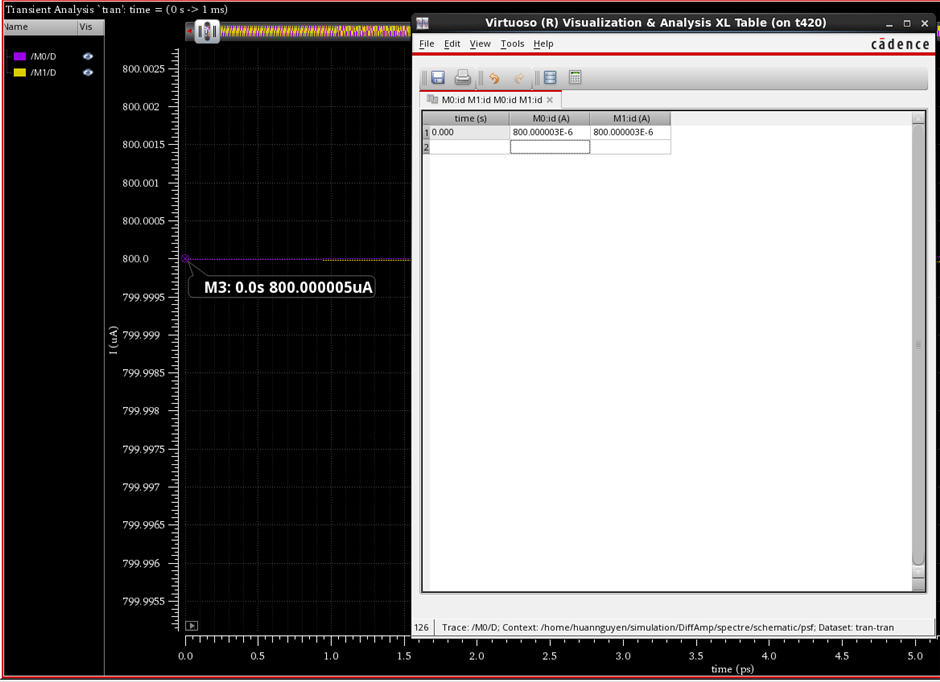

    Actually, I don't need that accuracy just to confirm my understanding about the two analyses. I thought that in transient analysis the zero time and stop time points of current should be equal to the transient operating points of current at time 0 and stop time respectively. However, that is not the case in my simulation.
    As you can see the transient operating point for id at the time zero:
    DC : M0:id =800.000003e-6  M1:id = 800.000003e-6
    TRAN 0: M0:id = 800.000003e-6 M1:id = 800.000003e-6
    However, when I run the transient analysis, then plot id and look at the id at time zero I got the result is a bit different:
    TRAN 0: M0:id = 800.000005e-6 M1:id = 800.000005e-6
    I thought they should be the same. I just want to confirm my understanding about the analysis. In this case the difference is insignificant. However, is there a case where the difference is large (beyond the tolerances )?
    No, not unless there is some circuit behaviour (such as something that hasn't settled in the duration of the simulation, or some adaptive non-periodic behaviour like a sigma-delta modulator) which means the beginning doesn't match the end.
