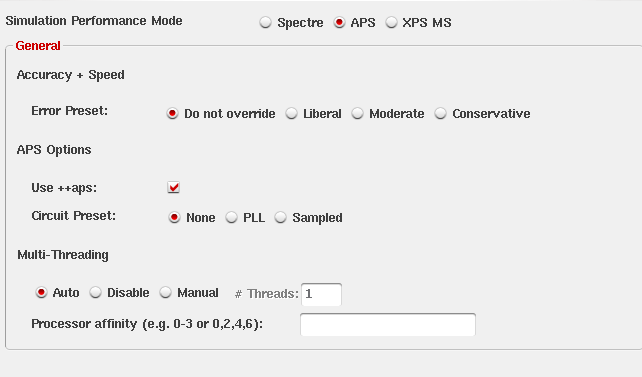

I am using the AMS simulator to run AMS sims.
In the "setup-high performance" menu, I choose APS. I enable ++aps and in the multi-threading part I choose auto.
Now I have a 4-core, 8-thread CPU and I am running simulation locally on my machine.
I expect the simulator to use all the cpus for simulation. When I look at the sim log file, it says
"Multithreading Enabled: 8 threads in the system with 8 available processors."
However, I also monitored the CPU usage during the simulation, and it only uses 140% cpu, instead of 600-800%.

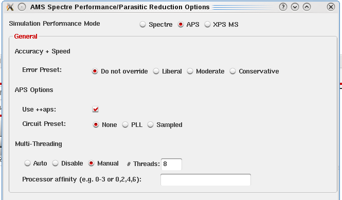

I also manually chose to use 4, or 8 threads (second screenshot below). It still just uses 140% cpu and the simulation time is the same.
The simulation takes one hour, I wonder why the simulator does not use all of the cpu to speed up the simulation.
How does it choose how many cores to use? what can I do to make it use the full capacity of the cpu?

    I read the following from some previous posts (community.cadence.com/.../22220)
    +multithread=N Turns on multithread capability. N is the specified number of threads. For baseline mode, at most 4 threads are allowed. For Turbo mode, at most 8 threads are allowed. You may use `+mt' as an abbreviation of `+multithread'
    Is this true? There is a limit of max 8 threads? This seems to be agreeing with what I've seen. I tried to run the sim on a 16core/32thread cpu, it still says 8 threads in the system with 32 available processors.
    So my question is two fold:
    1. how many threads can be used (maximum)?
    2. even with 4 ot 8 threads, why the cpu usage is only 140% instead of 400% or 800%
    This is confusing :(
    First of all, that thread was referencing some old help (older than the date of the post even), and that's no longer the limit; turbo is long dead, and APS can handle up to 64 threads now (however - this is unlikely to help unless the circuit is huge - millions of devices).
    You didn't give any information about the version of the simulator you're using, or (just as importantly) the size of the circuit. What you're probably seeing is a consequence of Amdahl's Law
    Essentially not everything can be computed in parallel - some things have to be done in series, and also the cost of managing the parallel threads may become prohibitive after a while. In AMS (in INCISIVE releases), the digital parts are not simulated in parallel - that's technology in the new XCELIUM release incorporating technology from our recent acquisition of Rocketick. For the analog parts (which is likely to be dominating your simulation performance), it will be dependent upon the number of (non-behavioural) components in the circuit - you would need potentially many thousands of devices to benefit significantly from multi-threading.
    Just chucking more CPUs at a problem doesn't always help.
