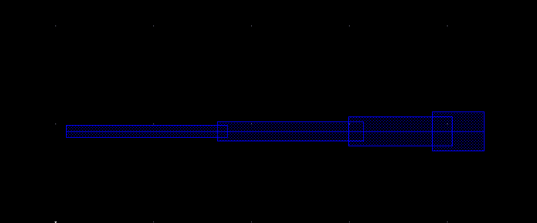

In layout editor, I would like to create a continuous (metal) routing (or path) which consists of pieces with different width. When I create a routing by pressing "p", the width is the same for each sub-part of the continuous path. Would it be possible to have what I want?

    I can do this by starting the wire, clicking where I want the width to change and then hitting F3 to bring up the options form and changing the width (which affects the new segment) clicking again, and so on. So I get:
    Is that the kind of thing you're after? I was trying in IC6.1.6.500.14 but it also works in IC617 ISR9 too (I think it's pretty likely it would work in ISR11 that you're using).

    Many thanks for the response. Yes this is the answer of what I wanted to have.
