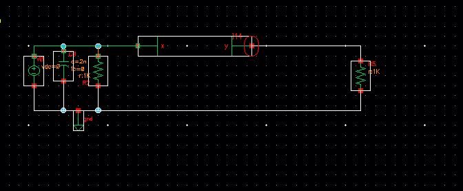

I want to design a vccs to implement this function:
I(y)<+ tanh(V(x));
I have done that using a verilogA model and I connect it in the cadence circuit which is as in the attached file, the model itself works fine but I want it to act as a real electronic component when connected to the circuit, by means when I change the output resistance the output current from this component should be changed accordingly as in the real electrical circuits, how can I do that, the current is always fixed and not affected by the resistor next to it. Because at the end I'll do a lab work by which I will use a similar component .
I read about bsource but I did not find it in any of the libraries !
any suggestion will be appreciated.
Thank you
    Whether you use VerilogA or bsource is not the point here - it's a matter of how you formulate the equation.
    Maybe you want something like:
    I(x,y) <+ tanh(V(x,y));
    The idea is that you want there to be a relationship where the current through the branch is a function of the voltage across it. I don't really know what you're trying to achieve though!
    Currently you are measuring the voltage at the input 9to ground), and generating an ideal current at the output (to ground); there is no current flow through the device itself.
    By the way, the bsource component is available in analogLib from IC617 ISR6 onwards.

    Actually I have a device in the lab made of an organic material and it generates tanh shape, I want to choose values for both R and C in the simulator and compare the output with the lab results.
  • Sali
    Sali over 9 years ago
    I tried writing V(x,y) but when I change the output resistor , it does not affect the output current which is does not happen in the real situation.
    Any other suggestion will be appreciated.
    Given that in VerilogA it's quite straightforward to write equations for a conservative system, it must just be that you've not captured the equation correctly. You can write an equation that relates the current through a branch to the voltage across it or vice versa - so it's easy to describe a capacitor, an inductor, or a resistor or some complex relationship which has elements of all of them in some non-linear way.
    Unless we are able to know how the actual measured data was made, and how it behaves, I doubt anyone can give you a suggestion as to what you should be doing - we're in the dark here!
