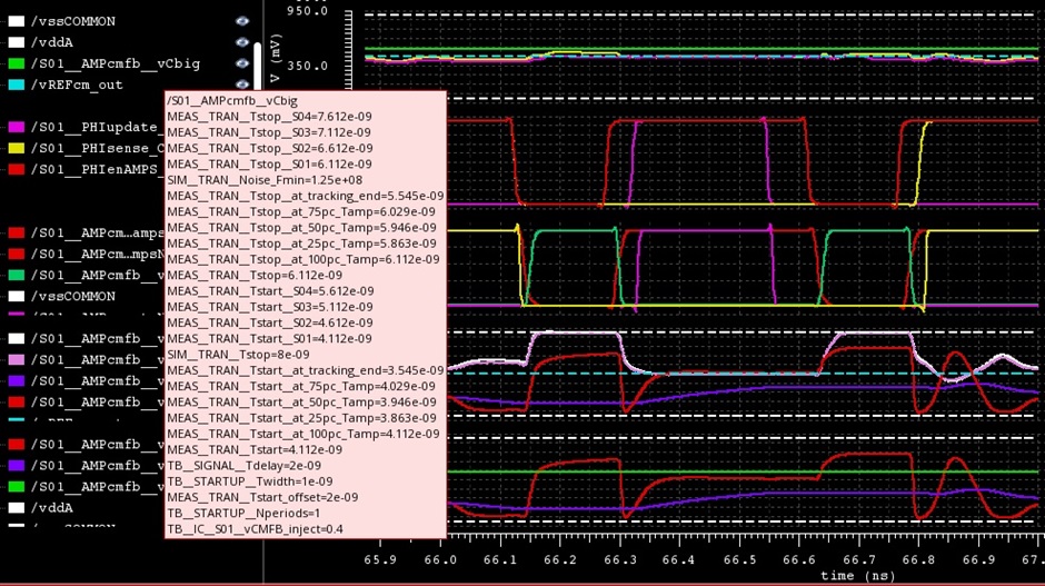

Hi! I recently updated to IC617 and now in Viva a window appears with the variables values whenever I hover the mouse over the trace names. I've been trying to disable this feature with no luck (menus, cdsenv settings). How can I achieve this? In attachment a snapshot of what I mean.
Thanks in advance for any help!
Jorge.

    This isn't currently possible, although there's a CCR which is related asking for more control over the legend which might be the way to address this. I can absolutely see why you want to turn it off!
    Can you either contact me directly via email (if you have my address) or log a support request and post the number here, so I can pick it up and join the dots with the CCR I already am aware of?

    Sure; I'll do it right away and post the request number here. Thanks for the quick reply, Andrew!

    Done! The request number is 46106287. Hope this helps to get this fixed soon.
    Thanks again for your help.
