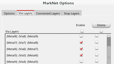

Lets say I have 10 metal process. I want to trace certain net from metal 5 to metal 8.  How do I use MarkNet Options, like what should be selected in Via layers, Connected layer, Stop layer ? I was giving metal 8 in stop layer but it didn't work. Can someone point to me to material that talk about right usage of stop layers. I am using ICADV12.1

    I think we do not need to use stop/connected layer functions. You can simply enable only M5~M8 layers in "Via Layers" section of the markNetOptions form as shown below:
    You can refer to "$CDSHOME/doc/vle/vlehelp.pdf" for more info on markNet "stop layers".
