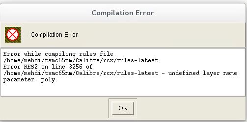

I am using Calibre PEX simulation for post layout simulation. Unfortunately when I load the rules and then trying to setup the inputs, the Calibre gives me the following compilation error. Unfortunately the Rules are encrypted and I can not check the line mentioned in the error message. How can I figure it out?

    Sometimes this can be caused by wrong versions, check if your are using the exact version of Mentor tools recommended by the design kit / foundry.
