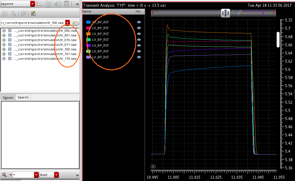

I'm using ViVA XL 6.1.7. When I use "Plot signals from all the open DBs" feature for comparing signal, it doesn't show the trace result dir at trance name.
So, it is difficult to differentiate the traces. Only way is to open "Trace info" window and check one by one.
Is there any way to show result dir or result name with trace both together?
Thanks
    Currently the trace info is the only way to do this (AFAIK). There is CCR 995738 (and in fact a number of other related CCRs) asking for some better means of distinguishing signals with the same name in the legend. You might want to contact customer support so that a duplicate can be filed to increase the priority of this getting implemented.
