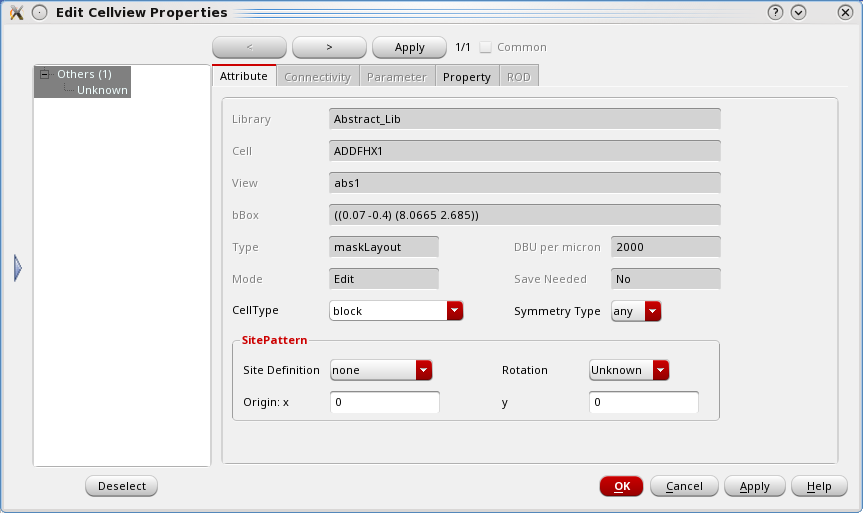

    Probably the simplest would be to use the abstract generator to build the abstract, but I suspect it's just that you're missing some cellView attributes and a prBoundary object.
    First edit the cellView properties (File->Properties) and fill in the CellType (I suspect yours is "none") - this sets the CLASS, and the Symmetry Type (this sets Symmetry in the LEF):
    Then you need a prBoundary object (not a shape on the prBoundary/drawing layer, but an actual object, as created by Create->P&R Objects->P&R Boundary
    Without this I get some pretty clear warnings in the CIW:
    WARNING: (OALEFDEF-90016): Design ADDFHX1 abs1 does not have a snapBoundary. Searching for a prBoundary.
    WARNING: (OALEFDEF-90017): Design ADDFHX1 abs1 does not have a prBoundary. Searching for a layer-purpose pair.
    WARNING: (OALEFDEF-90018): No shape on layer purpose pair found in the design ADDFHX1 abs1. The ORIGIN, FOREIGN, and SIZE statements will not be printed. Ensure that you have defined the snapBoundary, PRBoundary, or geometry on LPP (boundary, boundary) in the cellview.
    With it, I do get the ORIGIN, FOREIGN and SIZE entries.
    I do find that if you have the prBoundary/boundary layer purpose, it still works, although that's really not the supported flow nowadays. If you've used a different lpp (e.g. prBoundary/drawing) then it doesn't work and you get the warnings above.
  • anandmohan
    anandmohan over 8 years ago
    Hi Andrew,
    I followed your instructions and is working fine now. Thank you very much.
