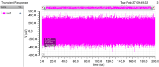

I have been trying to verify the variance (total power) of a random normal distributed noise source.
The noise source model has been modified from the noise_src in ahdlLib but with $rdist_normal() rather than $random()/`MAXINT
V(vout) <+ amp*$rdist_normal(seed,0,1);
where amp is exactly one sigma in normal distribution case.
In this example I give amp = 100u and the resulting output random signal is shown below:

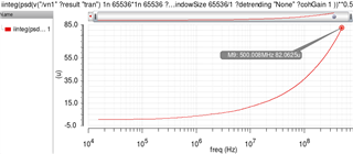

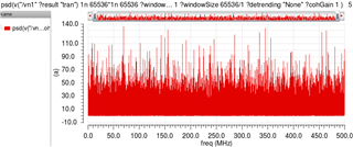

The PSD setup in VIVA Calculator and the result are shown as follows:
Then I apply iinteg to the PSD and take square root, and the integrated value at the final data point (0.5*sampling frequency)  is expected to be sigma=100u.
However, the outcome seems to be smaller than what is expected. ( (82u-100u)/100u ~ -18% error)

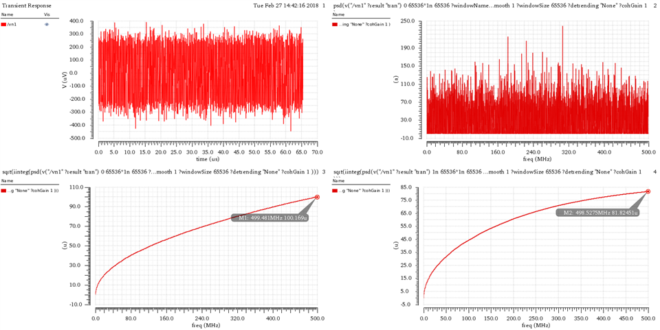

    I think this is because your limits are incorrect for the PSD. You need to set them to be between 0 and 65536*1n, not from 1n to 65536*1n. I ran my transient analysis and set strobeperiod to be 1/FSAMP (i.e. 1n). The ViVA PSD (and FFT) expects the interval to be the number of samples*sampleTime - it will however omit the very last point to ensure there are exactly 65536 samples in this case. What you're doing is messing up the sampling - you're probably getting lots of interpolation error by doing what you're doing (I didn't think too carefully what the root cause was). Seeing the graphs below - the bottom left is with the correct PSD interval, and the bottom right is with the interval you used:

    Indeed you've pointed out the problem I never thought before.
    The result is finally correlate with what I did in MATLAB after modifying the time interval you suggested.
    It's my bad to regard the VIVA calculator as taking the "FIRST/Start Time Point" and "LAST/End Time Point" for PSD or FFT calculation. (And that's why I took Ts ~ N*Ts.)
