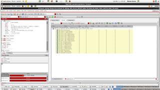

    Andrew Beckett over 8 years ago in reply to RFStuff
    Do you have more than one corner enabled? Or corner and nominal? Perhaps a screen shot would help...
  • RFStuff
    RFStuff over 8 years ago in reply to Andrew Beckett
     H
    Attached is the snapshot.  Also  I want to know whether it is becoming slow because of many output parameters to be evaluated as shown in the snapshot ?
    I have attached the generated the oceanScript  file of the ADEXL setup (ocean.txt) and the  oceanScript output parameter evaluation file (oceanMC.ocn) which  ADEXL refers.
    OK, there are 200 runs because you have 100 monte carlo points but two corners - nominal (which is the default test model setup) and corner C1. So that's 2*100.
    As for the number of outputs, it's not exactly excessive - and anyway that shouldn't hold up the simulation. I'm assuming you are giving the slowdown related to the times it gives in the spectre log file.
    Anyway, if you're already dealing with customer support, probably wise to continue talking to them - then an AE can look in more detail at your setup, check the timings and so on (especially as it's the weekend for me...)
