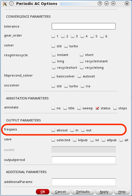

My question from https://community.cadence.com/cadence_technology_forums/f/custom-ic-design/38589/image-rejection-of-iq-mixer is still up :( So far I found the following hack: PSS+PAC, relative harmonic=1 and frequency sweep -100M ... 100M (for example). Then:
leafValue(v("/vodi" ?result "pac") "harmonic" -1) + (sqrt(-1) * leafValue(v("/vodq" ?result "pac") "harmonic" -1))
Similarly as combining the I/Q data in time domain I add them in frequency domain (pac data) as complex value. The problem is that this maps both the positive and negative frequencies to the same (positive) frequency values.
Question 1: When I plot this (or export to CSV/Table) one x value (e.g. 10 MHz) has 2 y values (one for positive and one for the negative frequency). How do I obtain the individual values? If I use value it just gives me the mean!
Question 2: Is there any way to modify the x-value of the pac data to include negative frequencies?
Thanks!
    Andrew Beckett over 8 years ago +1
    Quick answer - which may solve both questions (I don't have time post-vacation to do an experiment to check what you're saying as I have a lot of catching up to do!). On the pac options form, set the freqaxis…
    Quick answer - which may solve both questions (I don't have time post-vacation to do an experiment to check what you're saying as I have a lot of catching up to do!). On the pac options form, set the freqaxis parameter to "out" (rather than the default "absout"). Then you should get the negative frequencies in the data.

    I guess you mean "Sweeptype"? I tried that already ... no change between Relative/Absolute.
    However, I came up with a different solution now:
    value(dB20((mag((leafValue(v("/vodi" ?result "pac") "harmonic" -1) + (sqrt(-1) * leafValue(v("/vodq" ?result "pac") "harmonic" -1)))) / mag((leafValue(v("/vodi" ?result "pac") "harmonic" -1) - (sqrt(-1) * leafValue(v("/vodq" ?result "pac") "harmonic" -1)))))) 100000)

    No, I mean "freqaxis" on the PAC options form; not "sweep type" on the main PAC form:
